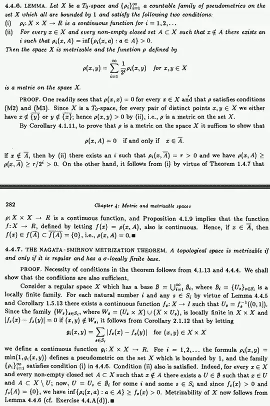

Given $\tau$, it is impossible to exactly recover $d$ when $X$ has more than one point. For instance, a discrete topology of a set $X$ can be generated by any premetric $d$ of $X$ such that for any $x\in X$ there exists $\varepsilon>0$ such that $d(x,y)>\varepsilon$ for each $y\in X\setminus\{x\}$.
Thus a generic problem is given a (pre)metrizable topological space $X$, construct a (pre)metric, generating topology on $X$. Usually $X$ is an infinite metrizable space, and a construction of a metric on it looks as in a following quotation from “General topology” by Ryszard Engelking (Heldermann Verlag, Berlin, 1989)).
Alex Ravsky
