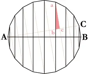

Archimedes showed that the surface area of a sphere is equal to four times the area of the base circle. Since the cylinder of the same height has the same area (by unfolding it), the assertion follows.

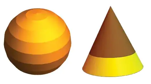

His proof involved approximating a sphere by a surface of revolution of a polygon inscribed in the circle, as follows: [Modern notation is in square brackets]
$\hspace{2cm}$enter image description here
Each section of the polygon-surface is a frustum of a cone. It was well-known that the curved surface area of a cone is the base circle times the ratio of the side length to the radius $$[\ =\pi r^2(l/r)=\pi rl\ ]$$ So the relevant yellow part is equal to the difference of two cones, equal to the sloping side length times the mean perimeter $$[\ \pi r_1l_1-\pi r_2l_2=2\pi\frac{r_1+r_2}{2}(l_1-l_2);\ \textrm{note that } r_1/r_2=l_1/l_2].$$
So the problem reduces to adding the mean perimeters of the polygon-surface, since the side-lengths are fixed [$l_1-l_2=BC$]. This sum is the same as adding the vertical diameters at the vertices $$[\pi\sum_i\frac{d_i+d_{i+1}}{2}=\pi\sum_id_i]$$
$\hspace{3cm}$enter image description here
This is where Archimedes' ingenuity comes to the fore: Draw another set of diameters, as in the faint red lines. They are cut by the off-diagonal $AC$ in two similar triangles, each similar to $\triangle ABC$. Each red triangle has a fixed ratio of its hypotenuse/height to its base [$ab:bc=AB:BC$], hence this is also the ratio of their sums. But the sum of the verticals is the required sum [$\sum_i(ab)_i=\sum_id_i$], while that of the bases is $AC$ [$=\sum_i(bc)_i$]. The conclusion is that the sum [$\sum_id_i$] is equal to the diameter times the ratio of the off-diagonal to the side [$AB.AC/BC$].
Combining the two results gives that the area of the polygon-surface is the base circumference times the off-diagonal [$\pi AB.AC$], which is less than four times the base circle area [$\pi AB^2$].
An identical argument with a circumscribed polygon, shows that the polygon-surface has area larger than an $\epsilon$ of the required area. Hence the result. $$[\pi AB.AC\to \pi {AB}^2,\quad \textrm{as } BC\to0.]$$
