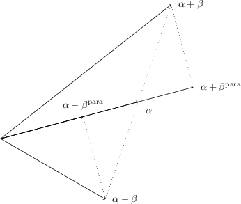

We'll prove it for non-zero $\alpha$ and $\beta$ (the claim is straightforward otherwise).
We resolve $\beta$ into components $\beta^{\mathrm{para}}$ parallel to $\alpha$ and $\beta^{\mathrm{perp}}$ orthogonal to $\alpha$ (see the vector projection page on Wikipedia for details). This is depicted below:
Resolving $\beta$ into $\beta^{\mathrm{para}}$ parallel to $\alpha$ and $\beta^{\mathrm{perp}}$ orthogonal to $\alpha$
Then \begin{align*} ||\alpha+\beta|| &= ||\alpha+\beta^{\mathrm{para}}+\beta^{\mathrm{perp}}|| \\ &= \sqrt{||\alpha+\beta^{\mathrm{para}}||^2+||\beta^{\mathrm{perp}}||^2} \end{align*} by Pythagoras' Theorem, since $\alpha+\beta^{\mathrm{para}}$ and $\beta^{\mathrm{perp}}$ are orthogonal. Similarly \begin{align*} ||\alpha-\beta|| &= ||\alpha-\beta^{\mathrm{para}}-\beta^{\mathrm{perp}}|| \\ &= \sqrt{||\alpha-\beta^{\mathrm{para}}||^2+||\beta^{\mathrm{perp}}||^2}. \end{align*} This is depicted below:
Identifying $\alpha+\beta$ and $\alpha-\beta$ in terms of $\alpha$, $\beta^{\mathrm{para}}$ and $\beta^{\mathrm{perp}}$
Hence $||\alpha+\beta||=||\alpha-\beta||$ if and only if $$||\alpha+\beta^{\mathrm{para}}||=||\alpha-\beta^{\mathrm{para}}||$$ which happens if and only if $\beta^{\mathrm{para}}$ is the zero vector (since $\alpha$ is non-zero). This happens if and only if $\alpha$ and $\beta$ are orthogonal.
