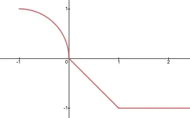

Define $\phi:(-1, \infty) \to [-1, \infty)$ as $$\phi(x) = \begin{cases} \sqrt{1 - (1+x)^2} & x \le 0\\ -x & 0 \le x \le 1 \\ -1 & 1 \le x\end{cases}$$
A graph is shown below. (Courtesy of Desmos.)
The graph
Clearly, $\phi$ is continuous and strictly decreasing in $(-1, 1)$. Thus, choosing $c = 0$ satisfies the conditions. (It has to be shown that $\phi$ is convex at this point but that is simple.)
However, the limit $\displaystyle\lim_{x\to0^-}\phi'(x)$ does not exist (as a real number).
To meet the conditions of your domain and codomain, consider $\tilde \phi := [x \mapsto \phi(x-1)+1].$
