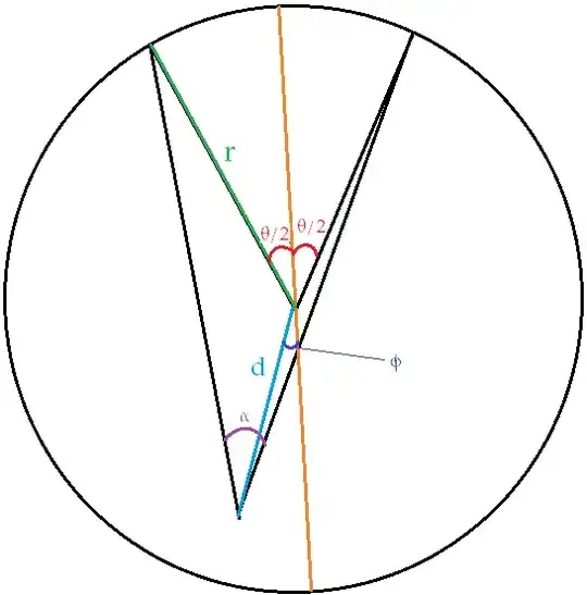

After trying to solve a geometry problem, represented by the following image
I've arrived at this expression:
$\alpha=\arccos\left(\frac{d+r \cos \left(\varphi+\frac{\vartheta}2\right)}{\sqrt{d^2+r^2+2 dr\cos \left(\varphi+\frac{\vartheta}2\right)}}\right)+\arccos\left(\frac{d+r\cos \left(\varphi-\frac{\vartheta}2\right)}{\sqrt{d^2+r^2+2dr\cos\left(\varphi-\frac{\vartheta}2\right)}}\right)$
Is there a way to simplify such expression?

  • https://math.stackexchange.com/questions/1116974/why-its-true-arcsinx-arccosx-frac-pi2 and https://math.stackexchange.com/questions/672575/proof-for-the-formula-of-sum-of-arcsine-functions-arcsin-x-arcsin-y – lab bhattacharjee Jun 28 '20 at 17:47
$$\arccos \beta +\arccos \gamma=\arccos \left(\beta\cdot\gamma-\sqrt{1-\beta^2} \cdot \sqrt{1-\gamma^2}\right)$$
On Wikipedia there are also these identities:
$$\arccos x_1+\arccos x_2= \begin{cases} \arccos\left(x_1x_2-\sqrt{1-x_1^2}\sqrt{1-x_2^2}\right)& x_1+x_2\ge0\\ 2\pi-\arccos\left(x_1x_2-\sqrt{1-x_1^2}\sqrt{1-x_2^2}\right)& x_1+x_2<0 \end{cases} $$
$$\arccos x_1-\arccos x_2= \begin{cases} -\arccos\left(x_1x_2+\sqrt{1-x_1^2}\sqrt{1-x_2^2}\right)& x_1\ge x_2\\ \arccos\left(x_1x_2+\sqrt{1-x_1^2}\sqrt{1-x_2^2}\right)& x_1<x_2 \end{cases} $$
