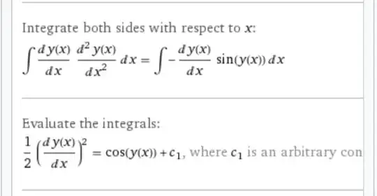

I saw this as a step in a calculation and it was confusing. The left cancels down to:
$$\int \frac{d^2y}{dx^2}dy$$
But surely the answer is $\frac{d^2y}{dx^2}y$; instead, $\frac {d^2}{dx^2}$ is being treated as a constant and not $\frac {d^2y}{dx^2} $
https://www.wolframalpha.com/input/?i=∫%28d%5E2y%2Fdx%5E2%29+dy. Putting in the calculation directly yields the result I would have expected.

For the left side you have that: $$I=\int y''y'dx= \frac 12\int(y'^2)'dx=\frac 12 \int \dfrac {d(y')^2}{dx}dx$$ $$I=\frac 12 \int d(y')^2=\frac 12 (y')^2$$
Note that; $$(y'^2)'=2y'y''$$

    so why do you get a different answer if you cancel and integrate for dy? @LewisKelsey Because from what you wrote $$ \int y''dy=\int \dfrac {dy'}{dx}dy=\int y' dy'=\frac 12 y'^2+c$$ It gives the same answer of course. – user577215664 Jun 24 '20 at 01:37

    @Axion004 Basically it goes like this $$\int \frac{d^2y}{dx^2} \frac{dy}{dx} dx \equiv \int \frac{d^2y}{dx^2}{dy}$$ $$\equiv \int \frac{d\frac{dy}{dx}}{dx} dy$$ $$\equiv \int d\frac{dy}{dx} \frac{dy}{dx}$$ $$\equiv \int dy'y'$$ $$\equiv \int y'dy'$$ $$\equiv \frac{1}{2} y'^2$$ it looks alright to me – Lewis Kelsey Jun 25 '20 at 16:37
    wolfram alpha will produce 1/2y'^2 for the former and y''y for the latter, which is what confused me – Lewis Kelsey Jun 25 '20 at 16:47
