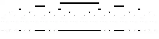

I looked at this 15 years ago.
Consider the interval $[0,1]$. Remove from it each point which represents a dyadic fraction (one of the form $\frac a{2^m}$ in lowest terms, i.e. whose binary expression terminates, in this case with $a$ and $m$ positive, $a$ odd and $a<2^mm$) and an interval around it. The remaining set of points (if any remain) is nowhere dense, and if the intervals are chosen suitably then the measure of the remaining points will be between $0$ and $1$. In this case the intervals removed will be of the form
$$\left[\frac a{2^m} - \frac k{2^{2m}}, \frac a{2^m} + \frac k{2^{2m}}\right]$$
with $k$ is a real constant where $0<k<2$.
By changing $k$ you can continuously affect the measure remaining for a set which contains no intervals and is nowhere dense. With $k=1$ it is $0.2677868402178891123766714\ldots$ with the black intervals removed looking like

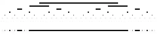

while with $k=\frac12$ it is double that at $0.5355736804357782247533428\ldots$ with the black intervals removed looking like
