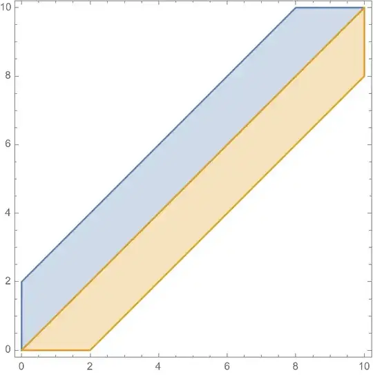

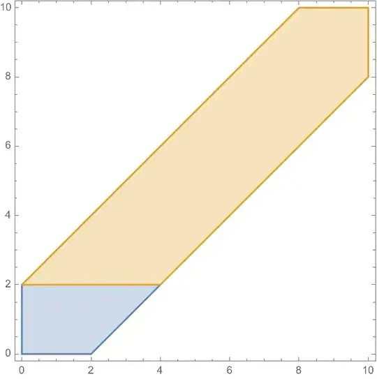

To really solidify the point, here are some diagrams of the regions of integration. The region described in the first setup looks like this: enter image description here The blue region is the first integral, and the orange is the second (where I've only plotted up to $x, y \le 10$ since obviously a plot to $\infty$ is not possible), for the choice $z = 2$. This illustrates why we must split the region into two parts, because if we integrated $x$ on $[y-z, y+z]$ for the blue region, you'd be including a portion in the second quadrant that is not allowed. But this is not the only way to split up the region: enter image description here This is the second approach I described. The blue region is the first integral, and the orange region is the second. This is possible because the order of integration of one integral is the reverse of the order in the other, whereas in the first setup, the order of integration is the same (horizontal strips). Here, we integrate the blue region in vertical strips, and the orange region in horizontal strips. And because of the symmetry, we don't even have to compute both--the contribution of the orange region is equal to the contribution of the blue.
