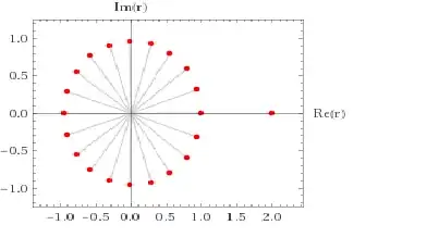

The solutions of these generalized Fibonacci problems rest on the resolution of the characteristic equation
$$r^m=r^{m-1}+r^{m-2}+\cdots r+1.$$ which can also be written $$r^{m+1}-2r^{m}+1=0$$ or $$1-2s+s^{m+1}=0$$ (where the solution $r=1$ must be discarded, and $s:=r^{-1}$). This equation has real as well as complex roots. Hence the solution of the recurrence is a linear combination of terms $$(a\cos(n\omega)+b\sin(n\omega))e^{n\tau}$$ where the constants $a,b$ are determined from the initial terms of the sequence (which you forgot to specify) and $\tau,\omega$ are the real and imaginary parts of the roots.
Note that one of the roots clearly dominates the others in modulus, and tends to $2$ with increasing $m$. Hence for large $m$ and large $n$, the solution is close to
$$c2^n.$$
This is justified by
$$2^{m}\approx 2^{m-1}+2^{m-2}+\cdots 2+1.$$
