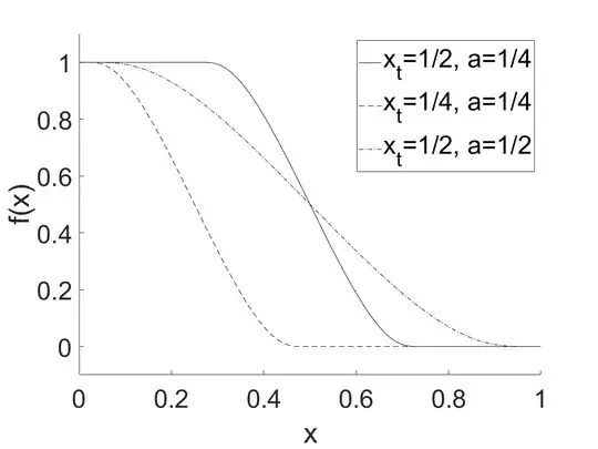

In formally writing down the constraints on $f'(x)$, I realized they're precisely those of a bump function. With this, I managed to construct an appropriate function $f(x)$:
$$f(x)=\begin{cases}1 & x\leq x_t-a \\ 1-\frac{1}{aI}\int_{x_t-a}^x\exp\left(\frac{1}{\left(\frac{x-x_t}{a}\right)^2-1}\right)\,dx & |x-x_t|<a \\ 0 & x\geq x_t+a\end{cases}$$
where
$$I=\int_{-1}^1\exp\left(\frac{1}{x^2-1}\right)\,dx.$$
This is constructed by letting $f'(x)$ be a bump function over the interval $(x_t-a,x_t+a)$ and integrating to retrieve $f(x)$. We can see that $f(x)$ is differentiable, and $f'(x)$ is a bump function. Thus $f(x)$ is smooth. Furthermore, $f(x_t)=1/2$ as desired, and the resulting slope is
$$f'(x_t)=\frac{1}{aeI}=s.$$
So, to control $s$ we set $a=1/seI$. One restriction to be aware of is that we must have $a\leq x_t$, giving the bound
$$s\geq\frac{1}{x_teI}.$$
Let me know if I've made any mistakes here. I would also like to see any other functions that satisfy the constraints.
Transition function for varying parameter values.
