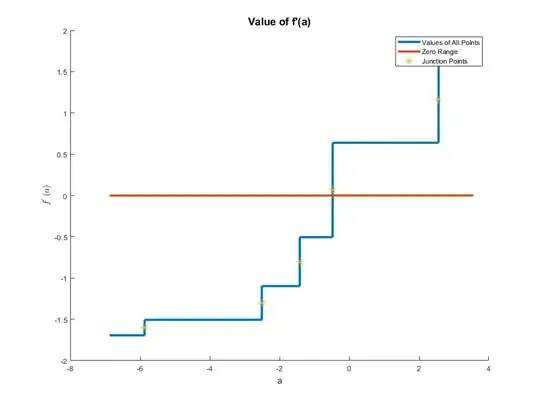

In the above figure one could see that each junction point has a vertical range associated with it. The optimal argument is the junction point which contains zero in its range.

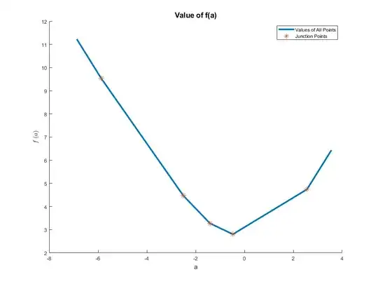

In the above figure one could see the value of the objective value. Indeed its minimum is attained on the junction point marked above.
