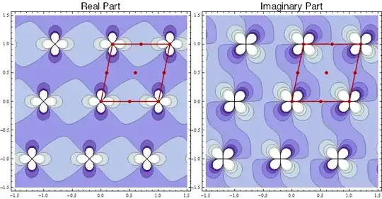

Intuitively, a "typical" elliptic function should have p1 symmetry. For example, the following plots show the function $\wp\,'(z)$ for the lattice generated by $1$ and $0.2+i$.
(Note: In this picture and all of the subsequent pictures, dark blue indicates negative values and light blue indicates positive values, while the white regions show the placement of the vertical asymptotes. All of these contour plots were produced in Mathematica.)

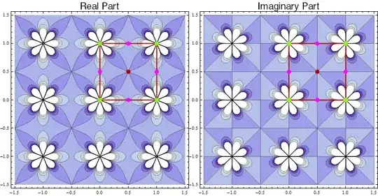

To get an elliptic function with p4 symmetry, we must use a square lattice, e.g. the lattice generated by $1$ and $i$. In this case, the square of the Weierstrass $\wp$-function has p4 symmetry. The following plots show $\wp(z)^2$ for the lattice generated by $1$ and $i$.
(There is $90^\circ$ symmetry around the red and green points, and $180^\circ$ symmetry around the purple points.)
More generally, let $G$ be the p4 symmetry group with a $90^\circ$ rotation at the origin. Then I would conjecture that an elliptic function for a square lattice is invariant under $G$ if and only if it can be represented as a rational function of $\wp(z)^2$. (And then every elliptic function with p4 symmetry can be obtained from these by translation.)

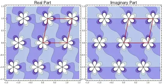

This appears to be the symmetry of the Dixon elliptic functions. However, it is not hard to make an elliptic function with p3 symmetry directly from Weierstrass $\wp$-functions. Using the lattice generated by $1$ and $e^{i\pi/3}$, the function $\wp\,'(z)$ has p3 symmetry:
(There is $120^\circ$ symmetry around each of the marked points.)
More generally, let $G$ be the p3 symmetry group of the function above. Then I would conjecture that an elliptic function for this lattice is invariant under $G$ if and only if it can be represented as a rational function of $\wp\,'(z)$. (Note that this includes the Dixon function $\mathrm{cm}(z)$, but that $\mathrm{sm}(z)$ is invariant under a translate of $G$.) Then every elliptic function with p3 symmetry would be obtained from these via translation.

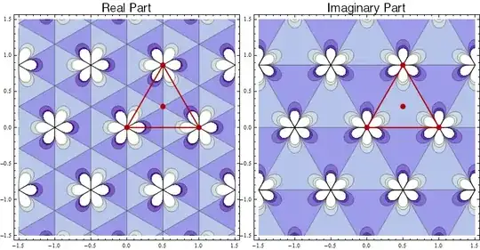

Type p6
This wallpaper group only makes sense for the hexagonal lattice. It involves translations as well as $60^\circ$ rotations, $120^\circ$ rotations, and $180^\circ$ rotations. Wikipedia uses the following image to illustrate p6 symmetry:
(The blue hexagons represent points with $60^\circ$ rotational symmetry, the red triangles represent points with $120^\circ$ rotational symmetry, and the purple rhombuses represent points with $180^\circ$ rotational symmetry.)
Again, it isn't too hard to make an elliptic function with p6 symmetry. We simply use $\wp\,'(z)^2$ for a hexagonal lattice:
(There is $60^\circ$ symmetry around the blue points, $120^\circ$ symmetry around the red point, and $180^\circ$ symmetry around the purple points.)
Again, it seems that $\wp\,'(z)^2$ "generates" the elliptic functions with p6 symmetry, in the sense that every elliptic function with p6 symmetry is a translate of a rational function of $\wp\,'(z)^2$.
