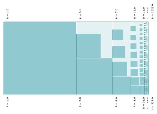

To "see" why $S_2<\infty$ and $S_1=\infty$ consider the "harmonic warehouse" problem where the warehouse worker must store infinite boxes with square bases of side $1/k$, for $k=1,2,3,\dotsc$. Looking from above at the warehouse, a $2\times1$ rectangle, subdivide it, starting from the west and moving eastwards into rectangular storage units of size $U_0:=1\times1$, $U_1:=1/2\times1$, $U_2:=1/4\times1$, etc. Each unit $U_l:=1/2^l\times1$ is then subdivided into $2^l$ subunits of size $1/2^l\times1/2^l$, now place the box of base $1/k\times1/k$ for $k=1,2,3,\dotsc$ in the first available subunit with $l=\operatorname{floor}(\log_2k)$ filling each unit from south to north.
You will obtain the following picture where the subunits are in light blue, the box bases are in middle blue and the sides are in dark blue. $S_2$ is the sum of box base areas, $S_1$ is the total of the dark sides, which for each unit $U_l$ cover a length larger than $1/2$ because the side of each box is larger than half its subunit's side.
It is now visually evident that $S_2<2$ while $S_1\geq1+1/2+1/2+\dotsb=\infty$.
