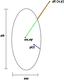

Assuming I have an ellipse with known center position (ex,ey) and size (ew,eh), how can I calculate the distance from x,y to the edge of the ellipse (in straight line from center)?
i.e. red line in the following image.
Note that the point can also be inside the ellipse (blue line).
Dist to point on ellipse
If it was a perfect circle the answer would be easy...
$d := |\sqrt{(x - ex)^2 + (y - ey)^2} - \text{radius}|$

As a preliminary, the equation for an ellipse is $x^2/a^2+y^2/b^2=1$, where the length of the major (long) axis is $2a$.
If we are given the center of the ellipse and a point $P(x,y)$ outside of the ellipse, then we can calculate the distance to the edge as in your diagram by calculating the distance $d$ between point $P$ and the center of the ellipse, then subtracting the distance between the intersection and the center of the ellipse.
By the Pythagorean Theorem, $d=\sqrt{(x-c_x)^2+(y-c_y)^2}$, where $c_x$ and $c_y$ are the $x$ and $y$ coordinates of the center of the ellipse respectively. The slope $m$ of this segment is $\frac{y-c_y}{x-c_x}$, so now we have the equation of a line: $y=mx+b$, where we can find $b$ by substituting our point $P$ or the center of the ellipse $(c_x, c_y)$. We can now substitute this equation into our ellipse equation to find the point on the ellipse that the line intersects, and then use the Pythagorean Theorem again to find this distance, which we'll call $d_1$. Now, the solution is $d-d_1$.

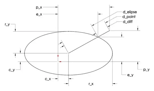

TLDR: In the situation pictured below
ellipse variable names
$d_{diff} = \sqrt{ (p_x-c_x)^2 + (p_y-c_y)^2 } - \sqrt{\frac{r_x^2 \times r_y^2 \times ((p_x-c_x)^2 + (p_y-c_y)^2)}{(p_x-c_x)^2 \times r_y^2 + (p_y-c_y)^2 \times r_x^2}}$
or, in the case that the ellipse is centered at the origin ($c_x = 0$ and $c_y = 0$)
$d_{diff} = \sqrt{ p_x^2 + p_y^2 } - \sqrt{\frac{r_x^2 \times r_y^2 \times (p_x^2 + p_y^2)}{p_x^2 \times r_y^2 + p_y^2 \times r_x^2}}$
Be warned that this is not the shortest distance from the point to the edge of the ellipse. Still, the value being calculated here is important in certain situations.
---THE REMAINDER IS THE BORING DERIVATION STUFF---
equation 1: $\frac{p_x-c_x}{p_y-c_y} = \frac{e_x-c_x}{e_y-c_y}$ (The points lie on the same line)
equation 2: $\frac{(e_x-c_x)^2}{r_x^2} + \frac{(e_y-c_y)^2}{r_y^2} = 1$ (equation of an elipse)
equation 3: $d_{point} = \sqrt{(p_x-c_x)^2 + (p_y-c_y)^2}$ (distance between two points)
equation 4: $d_{ellipse} = \sqrt{(e_x-c_x)^2 + (e_y-c_y)^2}$ (distance between two points)
equation 5: $d_{diff} = d_{point} - d_{ellipse}$
  1. Solving for $e_y-c_y$ with equation 1: $e_y-c_y = \frac{(p_y-c_y) \times (e_x-c_x)}{p_x-c_x}$
  2. Solving for $e_x-c_x$ by substituting line 1 into equation 2: $e_x-c_x = (p_x-c_x) \times r_x \times r_y \times \sqrt{\frac{1}{(p_x-c_x)^2 \times r_y^2 + (p_y-c_y)^2 \times r_x^2}}$
  3. Solving for $e_y-c_y$ by substituting line 2 into equation 1: $e_y-c_y = (p_y-c_y) \times r_x \times r_y \times \sqrt{\frac{1}{(p_x-c_x)^2 \times r_y^2 + (p_y-c_y)^2 \times r_x^2}}$
  4. Solving for $d_{ellipse}$ by substituting lines 2 and 3 into equation 4: $d_{ellipse} = \sqrt{\frac{r_x^2 \times r_y^2 \times ((p_x-c_x)^2 + (p_y-c_y)^2)}{(p_x-c_x)^2 \times r_y^2 + (p_y-c_y)^2 \times r_x^2}}$
  5. Solving for $d_{diff}$ by substituting line 4 into equation 5: $d_{diff} = \sqrt{(p_x-c_x)^2 + (p_y-c_y)^2} - \sqrt{\frac{r_x^2 \times r_y^2 \times ((p_x-c_x)^2 + (p_y-c_y)^2)}{(p_x-c_x)^2 \times r_y^2 + (p_y-c_y)^2 \times r_x^2}}$
---NOTES---
I tried generating some values and solutions for this problem in some CAD software, checked them against substituting $cos(\theta) = \frac{x}{\sqrt{x^2+y^2}}$ and $sin(\theta) = \frac{y}{\sqrt{x^2+y^2}}$ into user765629's equation and it did not produce the correct answer. I did the same for the equation I produced and it produced the correct answer.
