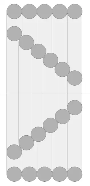

You can find the area of a solid of revolution by slicing it into circle and adding up the circumferences. But you have to be more judicious about how you slice.
The idea in the comments about wrapping wire rings around the surface is a good one. The figure below shows two surfaces of revolution: a cylinder, and a cone inside the cylinder.
All the wire rings are made from wire of the same thickness. But in the same distance along the axis of revolution in which we can fit five wire rings around the cylinder, we can fit seven wire rings around the cone.
Conceptually, it's very simple. Take the curve from which you generate the surface of revolution. Mark off equal distances along that curve and put a circle at each mark. Now the sum of the circumferences times the distance between circles along the curve is a reasonable approximation of the surface area, and becomes an accurate measure of the area once you turn it into a Riemann sum and take the limit as the distance goes to zero.
What you must not do is take circles whose centers are spaced at equal intervals along the axis of rotation and treat their circumferences as wires wrapped around the surface. The circles will be too far apart in the tapered sections of the surface. Consider what would happen if we replaced the seven rings in the figure about with five rings around the same cone; there would be gaps between the rings, and we would not be covering the entire surface.
In practice, marking off equal distances along a curve is not always easy. So instead we usually put the centers of the circles at equal distances along the axis of revolution, but multiply each circle's circumference by the distance between the circles along the curve, which is a larger distance in the tapering sections of the surface than in the cylindrical sections.

  • "What you must not do is take...." why not? As long as i will be taking the limit as n approaches to infinity. Wouldn't the gaps be filled as n approaches to infinity – EHM May 02 '20 at 15:00
  • And even if this method gives a less surface area as you have said why am I getting infinity. Shouldn't I be getting something less than what the conventional method give me. – EHM May 02 '20 at 15:05
  • If your wires only cover $70%$ of the surface when their thickness is $0.1$, then they will still cover $70%$ of the surface when their thickness is $0.01$ or $0.0001$ or $0.0000001.$ The gaps between the rings get smaller, but the number of gaps gets larger. – David K May 02 '20 at 15:17
    As for how you get infinity, I misunderstood your method at first due to the almost illegible pictures. I thought you were making the usual mistake of trying to adapt the disk method to area measurement without accounting for the $\sqrt{1+(f'(x))^2}$ factor. But you were literally just adding the lengths. This is never a correct way to measure area under any circumstances. Area is always length times width, so your "wire" should have a non-zero width so that it actually covers the area of the surface. As the number of circles gets larger, the width of the "wire" must get smaller. – David K May 02 '20 at 15:46
