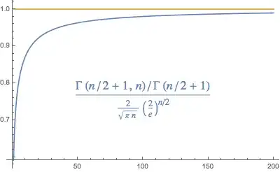

Since the maximum of $t^{n/2}e^{-t/2}=e^{-\frac t2+\frac n2\log(t)}$ occurs at $t=n$, we get that $$ t^{n/2}e^{-t/2}\le n^{n/2}e^{-n/2}\tag1 $$ Therefore, $$ \begin{align} 1-\frac1{\Gamma(n/2+1)}\int_0^n t^{n/2}e^{-t}\,\mathrm{d}t &=\frac1{\Gamma(n/2+1)}\overbrace{\int_n^\infty t^{n/2}e^{-t}\,\mathrm{d}t}^{\Gamma(n/2+1,n)}\tag2\\ &\le\frac{\left(\frac ne\right)^{n/2}}{\Gamma(n/2+1)}\int_n^\infty e^{-t/2}\,\mathrm{d}t\tag3\\ &=\frac{\left(\frac ne\right)^{n/2}}{\Gamma(n/2+1)}2e^{-n/2}\tag4\\ &\le\frac{\left(\frac ne\right)^{n/2}}{\sqrt{\pi n}\left(\frac n{2e}\right)^{n/2}}2e^{-n/2}\tag5\\ &=\frac2{\sqrt{\pi n}}\left(\frac2e\right)^{n/2}\tag6 \end{align} $$ Explanation:
$(2)$: $\Gamma(n/2+1)=\int_0^\infty t^{n/2}e^{-t}\,\mathrm{d}t$ is the Gamma Function
$\phantom{\text{(2):}}$ $\Gamma(n/2+1,n)=\int_n^\infty t^{n/2}e^{-t}\,\mathrm{d}t$ is the Incomplete Gamma Function
$(3)$: apply $(1)$
$(4)$: integrate
$(5)$: Stirling is an underapproximation (see Theorem $4$)
$(6)$: simplify
Thus, $$ \bbox[5px,border:2px solid #C0A000]{1-\frac2{\sqrt{\pi n}}\left(\frac2e\right)^{n/2}\le\frac1{\Gamma(n/2+1)}\int_0^n t^{n/2}e^{-t}\,\mathrm{d}t\le1}\tag7 $$ Apply the Squeeze Theorem.
The bound in $(6)$ is pretty close as $n\to\infty$:
robjohn
