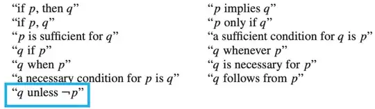

I have a discrete math book by Kenneth Rosen, and here is an excerpt from the book listing the equivalent ways to express $p \implies q$ in English. The one you mentioned is boxed in blue.
But where did you go wrong? I believe it was at this step
Now, substituting variables in given compound sentence. ($\neg q$) if (r unless s).
The word unless does not attach $s$ to $r$; it attaches $s$ with the proposition $\neg q$ if $r$. The reason for this is that there was a proposition established prior to unless, which was the statement, "You cannot ride the roller coaster if you are under 4 feet tall." That sentence is established as a proposition; it is the $q$ in the table I provided.
So the correct statement using your scheme is
$$\big( \, \neg q \, \textbf{ if } \, r \, \big) \, \textbf{ unless } \, s,$$ which is equivalent to $$\neg s \implies (r \implies \neg q).$$ Can you take it from here?
