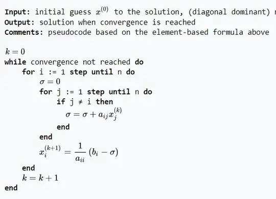

I am implementing the Jacobi Method and the Gauss-Seidel Method in the C programming language right now.
I successfully implemented the Jacobi Method and am getting the correct results for each iteration, but currently I struggle with implementing the Gauss-Seidel Method.
If I implemented both algorithms according to their pseudocode on wikipedia:
(Gauss-Seidel Method Algorithm)
(Jacobi Method Algorithm)
...then I would end up with the same implementation in the C programming language.
Both method obviously differ from one another, so instead of looking at the algorithms on wikipedia I instead decided to implement the methods by looking at their formulas.
(Gauss-Seidel Formula)
But my program code below doesnt work as intended yet. I get the wrong results for x^(k+1)
Here is my current source code:

Can somebody please tell me how my code differs from the Gauss-Seidel formula?
Since you have $i$ and $j$ starting from $0$ you used $<$ instead of $\le$ in the upper limit. That's fine. But you need to adjust the lower limit. When you start from $0$ it's fine. But the last term starts from $j=i+1$. You forgot to account for this.
