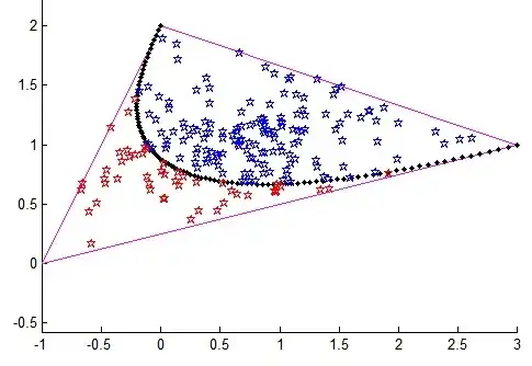

Here is a solution based on barycentric coordinates $(a,b,c)$ of point $M$ to be tested ; it relies on the following formula :
$$\left(\dfrac{1-t}{t}\right)^2 \ \ \iff \ \ t=\dfrac{1}{1+\sqrt{a/c}}\tag{2}$$
giving the value of parameter $t$ such that point
$$P_t = \text{line BM } \ \cap \ (B)$$
It remains plainly to test whether $BM/BP_t$ is $<1$ or $>1$.
Here is a figure showing it on random points (Matlab program) :
Explanation : Let us recall that (1) expresses naturally
$$(1 - t)^2, \ \ 2t(1 - t), \ \ t^2$$
as the barycentric cordinates of $P_t$ with respect to triangle $ABC$.
Let $(a,b,c)$ be the barycentric coordinates of point $M$.
As all points $(a',b',c')$ of line $BM$ are equally attracted by $A$ and by $C$, they are characterized by $a'/c'=a/c$, explaining relationship (2).
Now, how can we "short-circuit" barycentric coordinates ? Plainly by expressing them in "areal" terms :
$$a=\text{area MBC}, \ \ b=\text{area AMC}, \ \ c=\text{area ABM}\tag{3}$$
(no normalization needed for our purpose ; important : these areas are oriented areas).
Summary : being given $M$, one has to
1) compute ratio $ a/c = \text{area MBC}/\text{area ABM}$ (areas obtained by computing determinants)
2) apply formula (2) obtain $t$ (formula (2))
3) test whether $BM/BP_t \ \binom{<}{\geq}1.$
Remark : testing whether $M$ is inside triangle $ABC$ is easy using criteria $b=\text{area AMC}>0$ .
