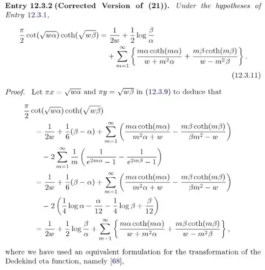

Berndt mentions that this formula is wrong and missing a term. The corrected version stands as $$\frac{\pi}{2}\cot\sqrt{w\alpha}\coth\sqrt{w\beta}=\frac{1}{2w}+\frac{1}{2}\log\frac{\beta}{\alpha}+\sum_{m=1}^{\infty} \left(\frac{m\alpha\coth m\alpha} {w+m^2\alpha} +\frac{m\beta\coth m\beta} {w-m^2\beta} \right) \tag{2}$$ for $\alpha>0<\beta,\alpha\beta=\pi^2$. Bruce gives some references which contain a proof of the above formula or its equivalents.
Bruce himself derives the above identity by using a change of variables in the following identity established by R. Sitaramchandrarao $$\pi^2xy\cot (\pi x) \coth (\pi y) =1+\frac{\pi^2}{3}(y^2-x^2)-2\pi xy\sum_{n=1}^{\infty} \left(\frac{y^2\coth (\pi n x/y)} {n(n^2+y^2)}-\frac{x^2\coth(\pi n y/x)}{n(n^2-x^2)}\right) \tag{3}$$ Ramanujan gave a similar (but wrong) formula and Sitaramachandrarao fixed it to arrive at $(3)$.
The derivation of $(2)$ from $(3)$ is not that difficult. The RHS of $(3)$ is modified using the identities $$\frac{y^2} {n(n^2+y^2)}=\frac{1}{n}-\frac{n}{n^2+y^2},\frac{x^2}{n(n^2-x^2)}=\frac{n}{n^2-x^2}-\frac{1}{n}$$ and $$\coth z =1+\frac{2}{e^{2z}-1}$$ The derivation also involves a transformation formula for logarithm of Dedekind eta function. However the proof of $(3)$ is omitted in Berndt's paper.

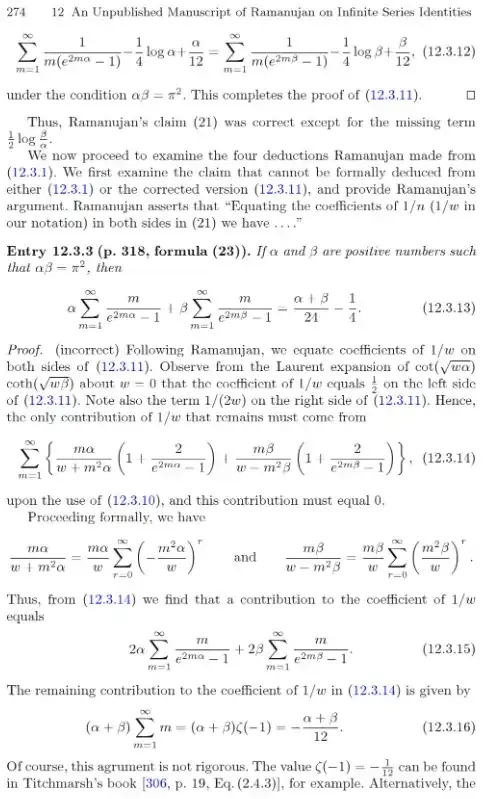

  • There is a proof without complex functions in the google book version of Ramanujan's Lost Notebook, Part 4 by George E. Andrews, Bruce C. Berndt page 273. – Jean Marie Feb 29 '20 at 10:06
  • @JeanMarie: It would be great if you can give the proof here as an answer. Even a brief outline or rough sketch would do. I was not able to find this reference online. – Paramanand Singh Feb 29 '20 at 11:56
Here are the exceirpts from "Ramanujan's Lost Notebook, Part 4" by George E. Andrews, Bruce C. Berndt pages 273 and 274 :
Jean Marie
  • 81,803
    Thanks and +1. Can you share the Google book link so that I can browse a few more pages? The current pages mention about equation 12.3.9 which is another equivalent formulation. And that also needs to be proved. – Paramanand Singh Mar 01 '20 at 04:37
    I was later able to find the desired reference on Google books but page 272 is not available for preview. Anyway by looking at available pages it appears that the content is almost same as that mentioned in paper of Berndt referenced in my question. – Paramanand Singh Mar 01 '20 at 05:00

    Thanks (+1)! The last sum involving $e^{2m\alpha}-1$ in denominator is handled via logarithm of Dedekind eta function. If $\eta(q) =q^{1/12}\prod_{n=1}^{\infty} (1-q^{2n})$ then $$\log \eta(q) =\frac{\log q} {12}-\sum_{n=1}^{\infty}\frac{q^{2n}}{n(1-q^{2n})}$$ and then we get desired sum if we put $q=e^{-\alpha} $. So the last part in your answer is simplified by use of transformation formula for Dedekind eta function. – Paramanand Singh Mar 02 '20 at 01:25
