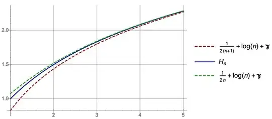

There are several inequalities giving upper and lower bounds on $H_n$, such as this one found on MathWorld (eqn 14):
$$\frac{1}{2(n+1)}<H_n-\ln n-\gamma<\frac{1}{2n}$$
