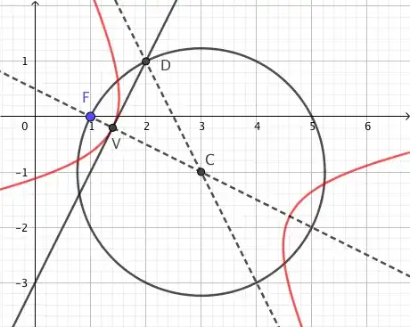

Indeed, the latter property suggests another way to construct the required equation. First, compute the intersection of the axis and asymptote to get the center $C$ of the hyperbola. Next, compute an intersection $D$ of the circle centered at $C$ that passes through the given focus with the asymptote (either of the intersections will do). From there, drop a perpendicular to the axis to get a vertex $V$ of the hyperbola. This construction is illustrated below:
Hyperbola construction
The semimajor axis length $a$ is then $CV$, while the semiminor axis length is the distance from the focus to the asymptote. The conjugate axis will have an equation of the form $2x-y+d=0$, and an equation of the hyperbola is therefore $${(2x-y+d)^2 \over a^2} - {(x+2y-1)^2 \over b^2} = 2^2+1^2.$$ I leave finding the unknown parameters to you.
