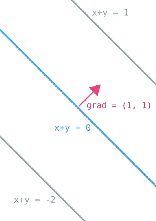

Now a particular example: $x + y = 0$:
The gradient points in the direction where the quantity $x + y$ increases. What we're interested is in all those points where $x + y = \texttt{constant}$. So:
  • our line is going to be perpendicular to the gradient, since our line does not want $x + y$ to change, while the gradient is the direction along with $x + y$ changes.
  • Hence, the gradient is going to be perpendicular to points on the line $L$.
