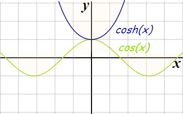

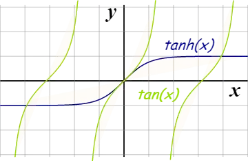

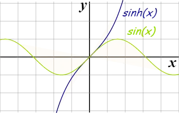

The followings are the graphical representation between geometric and hyperbolic functions (especially for $\sin x,~~\cos x,~~\tan x,~~\sinh x,~~\cosh x,~~\tanh x$ ).
