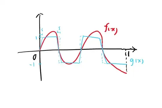

If we remove the restriction that $g$ is continuous, then this statement is trivial, as we can simply let $g = \sgn \circ f$. Then $f(x)g(x) = |f(x)|$ $\forall x \in [0,1]$. To adhere to the restriction, my idea is to construct a sequence of functions $g_n$ such that as $n \to \infty$, $g_n$ "looks more and more similar" to $\sgn \circ f$. The following is an illustration of my idea: enter image description here As one can see, $g$ behaves similar to $\sgn \circ f$, but when it is $\epsilon$ away from a zero point, it connects to the zero point linearly so to make it continuous. It's also clear that $\|g_n\|_\infty = 1$, unless $f \equiv 0$, in which then it is a trivial case. My idea is to let $\epsilon = \frac{1}{n}$, for each $g_n$, and show that: $$ \lim_{n \to \infty} \int_0^1 f(x)g_n(x) \d{x} = \int_0^1 |f(x)| \d{x} $$ The following is my attempt to formulate a rigorous construction of $g_n$:

My main issue here is that, given the complicated structure of $g_n$, I'm not sure how to evaluate $\int_0^1 f(x)g_n(x) \d{x}$ or bound it properly. I'm also not sure how dense $X_0$ is in $[0,1]$, so I can't seem to guarantee that the measure of the set $Y_\epsilon := \{(x - \epsilon, x + \epsilon) : x \in X_0\}$ tends to zero, which is probably necessary to show my statement.
