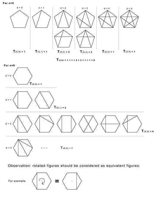

Here we have a simple, but a very hard problem: How many different figures (or graphs) can be formed with a regular polygon of n vertices and a number d of diagonals of this polygon?
Consider T(n,d) the total number of distinct figures formed by the polygon of n vertices and d diagonals. The question is: how to determine T(n,d)?
The figure below shows some examples for the pentagon (n=5) and hexagon (n=6), to better understand the problem:
OBS: Rotated or reflected figures will also be considered the same!
I thought about using Polya´s Enumeration Theory, but I didn't understand how I can do that. There seems to be a similarity with the method of counting graphs by Polya´s Counting Theory, or still similar to the circular coloring problem solved by Polya.
Does anyone have any ideas or methods to solve this problem?

That last one is one more than you counted, and indeed you missed a figure:
This differs from your first figure by a reflection. (Alternatively, you may have forgotten to mention that you want to consider reflected figures as equivalent; that would of course require a slightly different analysis.)

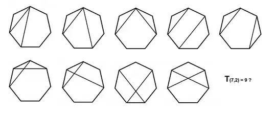

  • Hello joriki, I did a test for $R(7,2)$ and noticed a difference between the result of the formula and the possible figures. Below I show my analysis. Did I misinterpret the formula or am I not seeing another possible figure? Where am I wrong? Help me! – JaberMac Mar 04 '20 at 14:42
A doubt: applying the formula for the case $n = 7$, $d = 2$ (Heptagon with $2$ diagonals), we have $R(7,2) = 10$. But analyzing the possibilities as shown in the figure below, we find $R(7,2) = 9$ ways: enter image description here By the formula, with odd n, we have: $$ R(n,d)=\frac1{2n}\left(\sum_{k\mid\gcd(n,d)}\phi(k)\binom{\frac12\frac nk(n-3)}{\frac dk}+n\left[\frac{n-3}2,\frac{(n-1)(n-3)}4\atop d\right]\right) $$ $$ R(7,2)=\frac1{14}\left(\sum_{k\mid 1}\phi(1)\binom{\frac12\frac 71(7-3)}{\frac 21}+7\left[\frac{7-3}2,\frac{(7-1)(7-3)}4\atop 2\right]\right) $$ So, $$ R(7,2)=\frac1{14}\left(1\binom{14}{2}+7\sum_{j=0}^{\left\lfloor\frac 22\right\rfloor}\binom2{2-2j}\binom6j\right) $$ $$ =\frac{1}{14}\left(1\cdot\binom{14}{2}+7\cdot\left(\binom22\binom60+\binom20\binom61\right)\right) = 10 $$ The doubt: $R(7,2) = 10$ or $9$? Did I misinterpret the formula? Is there another way that I am not seeing in the illustration above? Or is the formula not correct? What's wrong?
