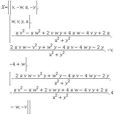

In general, the equation
$X^2+aSX+bI=0$ ($a,b\in\mathbb{R}$) admits many solutions that are non-skew.
For example, let $a=-4,b=2$. The solutions depend on $4$ real parameters $u,v,w,y$ s.t. $u^2+y^2\not= 0$. More precisely, the general solution has the form
The skew-symmetric solutions are obtained for $v=0,u+X_{3,1}=0$, and then, depend on $2$ parameters.
