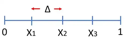

Imagine I generate $N$ real numbers with a uniform distribution between $0$ and $1$. I sort them in ascending order. And I calculate the differences between each consecutive pair.
For example, for $N = 3$, it would be like this:
I would like to know what is the expected value of that differences, $\Delta$. Each pair will have a different $\Delta$ but I'm just interested on the average expected value of all $\Delta$.
As I don't know how to calculate it with equations I've done it with a simulation instead (I'm not mathematician nor statistician, I just work with computers). And what I've gotten is: if I have $N$ numbers the average distance between them is $\frac1{1+N}$, and that's also the value between the first number and zero.
I would like to know how to calculate this with equations. Intuitively I think it's the same as calculating $E\left[|X_i-X_j|\right]$ where $X_i$ and $X_j$ are two neighboring numbers in that sample.

Here's a somewhat more roundabout way of obtaining the result, assuming the originally chosen numbers $\ Y_1, Y_2, \dots, Y_N\ $ are independent.
The arithmetic mean difference between the ordered numbers is $\ \Delta=\frac{\sum_\limits{i=1}^{N-1} \left(X_{i+1}-X_i\right)}{N-1}=\frac{X_N-X_1}{N-1}\ $, and the joint distribution of $\ X_1, X_N\ $ can be calculated from \begin{align} P\left(a\le X_1, X_N\le b\right)&=P\left(a\le Y_1,Y_2,\dots,Y_N\le b\right)\\ &=\cases{\left(\min(b,1)-\max(a,0)\right)^N& if $\ b>\max(a,0) $\\ 0& otherwise} \end{align} and \begin{align} P\left(X_N\le b\right)&=P\left(Y_1,Y_2,\dots,Y_N\le b\right)\\ &=\cases{\min(b,1)^N&if $\ b>0$\\ 0& otherwise} \end{align} since \begin{align} P \left(X_1\le a, X_N\le b\right)&= P\left(X_N\le b\right)-P\left(a\le X_1, X_N\le b\right)\\ &=\cases{\min(b,1)^N-\left(\min(b,1)-\max(a,0)\right)^N & if $\ b>\max(a,0) $\\ 0&otherwise} \end{align} The joint density function $\ f(x,y)\ $ of $\ X_1,X_N\ $ is therefore given by \begin{align} f(x,y)&=\cases{N(N-1)\left(\min(y,1)-\max(x,0)\right)^{N-2}& if $\ y>\max(x,0)$\\ 0& otherwise} \end{align} and the expectation $\ E(\Delta)\ $ of $\ \Delta\ $ by \begin{align} E(\Delta)&=\int_0^1\int_x^1\frac{y-x}{N-1}\cdot N(N-1)(y-x)^{N-2}dydx\\ &= N\int_0^1\int_x^1(y-x)^{N-1}dydx\\ &=\int_0^1(1-x)^Ndx\\ &= \frac{1}{N+1} \end{align}

    Oh, I'm sorry. $\ Y_1, Y_2, \dots, Y_N\ $ are just the uniformly distributed random numbers originally chosen before they were reordered to get $\ X_1, X_2,\dots, X_N\ $. For the derivation to work, the $\ Y$s have to be assumed independent, even though the $\ X$s won't be. In fact, the result won't necessarily be true if the $\ Y$s aren't independent. – lonza leggiera Jan 30 '20 at 01:03
Since there are $N+1$ subintervals and their lengths add to $1$, the average subinterval length is $\frac{1}{N+1}$.
