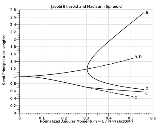

A Maclaurin spheroid can become a Jacobi ellipsoid but I don't understand how this happens. From the plot I see that it must be spinning fast enough and from the text there seems to be some viscous damping necessary, in the Jacobi ellipsoid I'd assumed that the fluid rotates as if it were a rigid body.

Jacobi Ellipsoid and Maclaurin Spheroid; a, b, c vs normalized angular momentum
image Source
Caption in Wikipedia:
The equatorial (a, b) and polar (c) semi-principal axes of a Jacobi ellipsoid and Maclaurin spheroid, as a function of normalized angular momentum, subject to abc = 1 (i.e. for constant volume of 4π/3).
The broken lines are for the Maclaurin spheroid in the range where it has dynamic but not secular stability - it will relax into the Jacobi ellipsoid provided it can dissipate energy by virtue of a viscous constituent fluid.
Description on the source page:
A plot of the long (a), middle (b) and polar (c) semi-principal axes of a Jacobi ellipsoid and Maclaurin spheroid (spinning bodies of homogeneous self-gravitating fluid in equilibrium), against normalized angular momentum, subject to abc = 1 (i.e. for constant volume of 4π/3).
The lines for the Jacobi ellipsoid go_beyond the point where the piriform (pear-shaped) equilibrium body could exist. According to Cartan the Jacobi ellipsoid loses all stability at this point. However, it unclear how this is to be reconciled with the fact that the piriform body is itself unstable and has a higher energy than the ellipsoid (see Christodoulou, "Phase-Transition Theory of Instabilities. III. The Third-Harmonic Bifurcation on the Jacobi Sequence and the Fission Problem", https://arxiv.org/abs/astro-ph/9505008 )...
update: There is a potentially very helpful historical review in Jérémie Vidal, David Cébron's 2017 arXiv Inviscid instabilities in rotating ellipsoids on eccentric Kepler orbits
