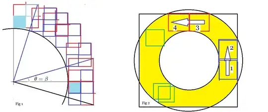

At first it appears that the inner vertex of the square is a circle of radius $r$ and outer vertex goes on circle radius $ r+ \sqrt2 l $.
However the constraint of parallel displacement of squares forces the squares to move horizontally or vertically maintaining sliding contact at four points $$(r,0), (0,r),(-r,0), (0,-r) $$ with square side sliding on circle radius $a$ at the above points. It also defines an outer square envelope of side $(r+l)$ serving as outer boundary.
A rough sketch (sorry about the hand drawn Paint diagram) can indicate what is happening at outer boundary.
If $\tan β=\dfrac{l}{l+r}$ then the eight demarcation of change over polar angles to flat square boundary are given by:
$$ θ= β, π/2-β,π/2+β, π-β, π+β, 3π/2-β, 3π/2+β,-β$$
How do I rotate.. Mathematica has RegionPlot command defining swept area:
r=a; a = 2; l = 1; RegionPlot[{x^2 + y^2 > a^2, x^2 + y^2 < (a + Sqrt[2] l)^2, Abs[x]
< a + l, Abs[y] < a + l}, {x, -4, 4}, {y, -4, 4} ]

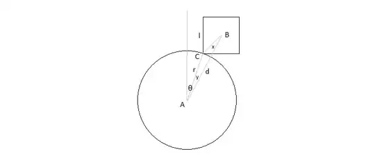

The path can be expressed in terms of the distance $d$ = AB as a function of the angle $θ$ that the distance line forms with the vertical axis.
Consider $θ$ in the first quadrant first. In the case where the sides of the square are in contact with the circle, B moves either horizontally or vertically, and the distance function is given simply by
$$d\left( θ \right) =\left( r+\frac{l}{2} \right) \sec θ ,θ \in \left( 0,\tan ^{-1}\frac{l}{2r+l} \right) $$ $$d\left( θ \right) =\left( r+\frac{l}{2} \right) \csc θ ,θ \in \left( \cot ^{-1}\frac{l}{2r+l},\frac{π}{2} \right) $$
On the other hand, if the vertex C is in contact with the circle, where $θ\in(\tan^{-1}\frac l{2r+l},\cot^{-1}\frac l{2r+l})$, apply the sine rule to the triangle ABC,
$$\frac{\sin x}r = \frac{\sin y}{\frac l{\sqrt2}}=\frac{\sin(x+y)}d$$
which leads to $d=r(\cos y + \cot x\sin y)$ and $\sin y = \frac l{\sqrt2 r}\sin x$. Recognize that $x=45-θ$ and eliminate $y$ to obtain the path function
$$d\left( θ \right) =\frac{1}{\sqrt{2}}\left( \sqrt{2r^2-l^2\sin ^2\left( 45-θ \right)}+l\cos \left( 45-θ \right) \right) $$
Similar expressions can be obtained for $θ$ in the other quadrants.
