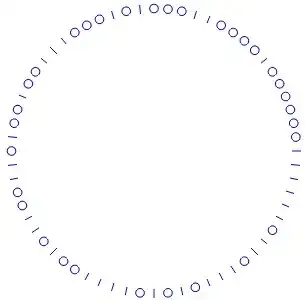

Fig. 2 : "Rotating drum" able to generate every number with a binary representation of 6 bits (from '000000' to '111111') by selecting 6 consecutive digits on the drum (De Bruijn sequence $B(6,2)$).
