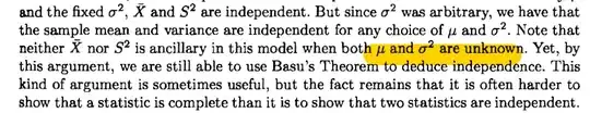

I have a question regarding the use of Basu's Lemma. Assume that $$X \sim N(\theta, \sigma^2).$$ In that case, we can use Basu's Lemma to show that $$\bar{X}$$ and $$S^2= \frac{1}{n-1}\sum(X_i-\bar{X})^2$$ are independent, if we show that $T:=\bar{X}$ is complete and sufficient (e.g. by the definition of exponential families) and that the distribution of $S^2$ does not depend on $\theta$ which is the case here. However, when $\sigma^2$ would be unknown as well, the distribution of $S^2$ would depend on $\theta$. Can we still use Basu's Lemma somehow to show independence in that case ? I was confused by the following statement in the book Statistical Inference by Casella and Berger on p.289:

1When both $\theta$ and $\sigma^2$ are unknown, distribution of $S^2$ depends on $\sigma^2$ only; distribution $\overline X$ depends on $\theta$ in any case. So neither the distribution of $\overline X$ nor that of $S^2$ is independent of the parameter $(\theta,\sigma^2)$ as mentioned in highlighted sentence. (BTW I don't understand why this is flagged as 'belongs on stats.SE'.) – StubbornAtom Jan 10 '20 at 15:27
And indeed we can still use Basu's theorem. See example 6.6.15 here or https://math.stackexchange.com/a/50598/321264. – StubbornAtom Jan 10 '20 at 15:30
