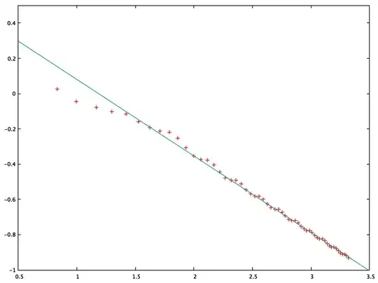

Here's Java code that finds the primes without proper prime prefix and sums $\frac1p$ and $\frac1p-\log\left(1+\frac1p\right)$. The sum of $\frac1p-\log\left(1+\frac1p\right)$ converges to double machine precision with $p\le10^8$; the result (plus $\log10$) is $2.48111396244$. By contrast, with $p\le10^8$ the direct summation of $\frac1p$ only reaches $2.01$. With $p\le10^{12}$, it’s still at $2.09$. Below is a plot of the partial sums of $\frac1p$ for $p\le x$. The abscissa is $\log\log x$; the ordinate is $-\log(S-S(x))$, where $S(x)$ is the partial sum and $S$ is the limit (as determined from the rapidly converging sum). Since the fraction of the sum that's missing at $p\le x=10^n$ is asymptotically proportional to $n^{-1/\log10}\propto(\log x)^{-1/\log10}$, we'd expect this plot to be asymptotic to a line with slope $-\frac1{\log10}$. The green line is a line with that slope fitted to the data. The good agreement of the fit with the data confirms the value of the limit.
log log vs. log error plot of the sum of reciprocals
