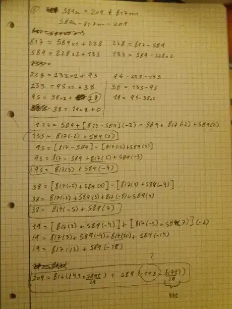

I did this
Apparently this is wrong because the right answer is $17+43t$ for $0 \le t \le 18$. What went wrong? I know this is supposed to have 19 solutions but what I got was $-198 \pmod {817} + 43t$ and -198 mod 817 isn't 17.
Nothing really went wrong.
You got $589(-198+43t)\equiv209\bmod817$.
By the mod distribution law, this is equivalent $(\div19)$ to $31(-198+43t)\equiv11\bmod43$.
So $x\equiv-198 \equiv17\bmod43$.
So $x\equiv17+43t\bmod 817$.
You could have noted from the beginning that $589, 209, $ and $817$ are all multiples of $19$, so
$589x \equiv 209 \pmod {817}\iff31x\equiv11\pmod{43}.$
This can be solved using the Bezout identity $13\times43-18\times31=1$:
$x\equiv-18\times11=-198\equiv17\pmod{43}$,
so $x\equiv 17, 60, 103, 146, 189, 232, 275, 318, 361, 404, 447, 490, 533, 576, 619, 662, 705, 748, $
or $791\bmod 817$.

  • Why do I have to use this though and why can't I leave the answer as it is? It's still correct. – Segmentation fault Jan 01 '20 at 20:16
    You could leave it – J. W. Tanner Jan 01 '20 at 20:25
  • I think I get it, I was supposed to divide $589 \equiv 209 \pmod{817}$ by 19, which is gcd(817,589) to simplify things so I would have to work with big numbers. Then I was supposed to solve normally for $31x \equiv 11 \pmod{43}$, which gives me $1 = 43(13+31t)+31(-198-43t)$, multiply everything by 11, which gives me $11 = 43(143+31t)+31(-198-43t)$. Then do -198 mod 43, which is 17, and my answer is 17-43t for $0 \le t \le 18$. I suppose I was just missing the simplification. – Segmentation fault Jan 01 '20 at 21:02

Your solution is correct since $\bmod 43\!:\ x \equiv -198 \equiv 5(43)-198\equiv \,\bbox[5px,border:1px solid #c00]{\!\!17}$
