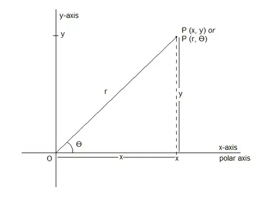

For starters, we need to look at the set of complex numbers. We can write complex numbers as $x+yi$, but they can also be represented in what is called polar form, as an angle and a magnitude.
polar
Accept the following: When we multiply two complex numbers together, we multiply their magnitudes (not as important for this topic) and add their angles (very important). For example, the complex numbers at $(1, 30^\circ)$ and $(1, 40^\circ)$ will have a product located at $(1, 70^\circ)$.
