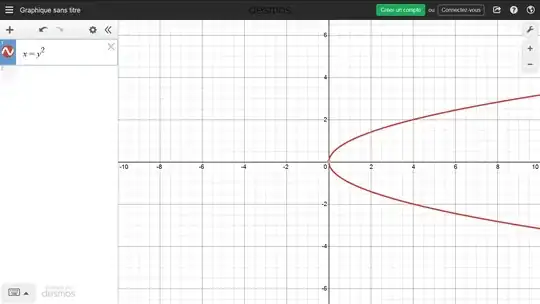

Other example :
The set of all pairs of real numbers (x, y) such that y = x² is a function.
It's inverse relation is the set of all pairs (x,y) such that x = y².
A vertical line test will show you that this inverse relation is not a function.
