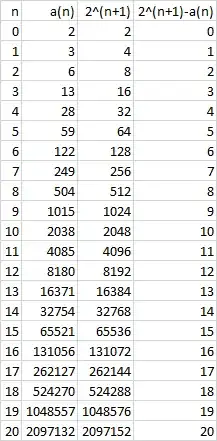

I made a spreadsheet, calculating $a_n$ further than you did, and saw a pattern,
where $a_n$ became close to powers of $2$.
I then made an additional column with the difference between $a_n$ and $2^{n+1}$
and saw a further obvious pattern there.
That led me to hypothesize that $a_n=2^{n+1}-n$, which I then easily proved by induction.
