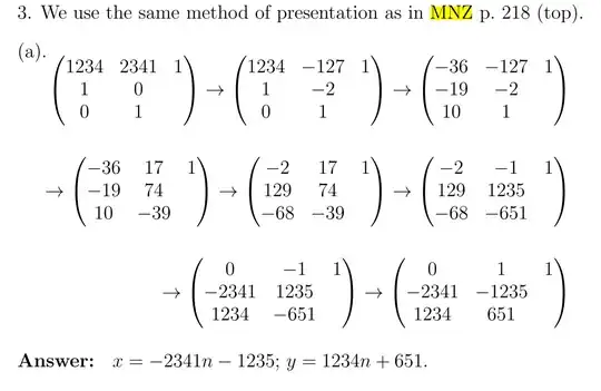

I see in this document the following method to solve the Diophantine equation $1234x+2341y=1$:
It looks pretty useful and interesting, but I don't know what the cited work MNZ p.218 is. Can anyone tell me how this method works?

MNZ refers to Montgomery, Niven, Zuckerman. Your method is presented in Chapter 5, Section 1, pages 212-218 in the Fifth Edition. Your example begins with two coprime numbers, so the final diagram finishes the problem. The problem shown at the top of page 218 deals with a gcd of 3, a little extra work needed.
Instead of row operations, they are using column operations, building one step at a time. Begin with row vector $r = (1234, 2341)$ and construct square matrix $M$ such that $rM = (0,1).$ Here we have constructed $\det M = \pm 1.$ It follows that the dot product of $r$ with the right hand column of $M$ is $1.$ Furthermore, the dot product of $r$ with the left column of $M$ is zero, so we may freely add any multiple (they use $t$) of the left column of $M$ and still have a solution.
