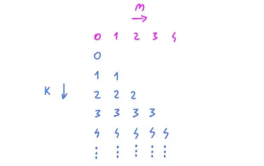

By double counting, since the sum by columns must be equal to the sum by rows, we obtain that
$$\sum_{n=0}^\infty \sum_{k=n}^{\infty} a_k = \sum_{k=0}^{\infty}\sum_{n=0}^{k} a_k= \sum_{k=0}^{\infty}a_k\sum_{n=0}^{k}1 =\sum_{k=0}^{\infty}(k+1)a_k$$

  • Yes, this is wonderful and the picture is exactly what I have also drawn (only on the paper ;-)). Only small question: how you justify rigorously the first equality? How do you swap the sums? Intuitively OK; formally? Is it a theorem? Thanks. – Romeo Nov 21 '19 at 21:58
  • @Romeo I think it is more than sufficient as a proof. In the first case we sum by columns in the other by rows and the two sums must be equals. In case you are iterested in other ways, here you can find something. – user Nov 21 '19 at 22:01
  • We can interchange the order of summation by Tonelli's theorem, since the $a_n$ are nonnegative. – Math1000 Nov 21 '19 at 22:18
