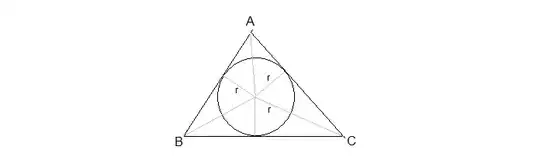

The area of the triangle is
$$S= \frac12 r (a+b+c)=\frac12 rp\tag 1$$
Also,
$$p=2r\left(\cot \frac A2 + \cot \frac B2 + \cot \frac C2\right)\tag 2$$
Combine (1) and (2) to get
$$S= \frac{p^2}4\cdot \frac 1{\cot \frac A2 + \cot \frac B2 + \cot \frac C2}$$
Since $\cot \theta $ is a convex function over $\theta\in (0,\frac\pi2)$, the following holds according to Jensen's inequality,
$$\cot \frac A2 + \cot \frac B2 + \cot \frac C2 \ge 3\cot\frac{A+B+C}6=3\cot\frac{180^\circ}6=3\sqrt3$$
where the equality holds for $A=B=C = 60^\circ$. Thus, the largest area, given by $S_m=\frac{p^2}{12\sqrt3}$, comes from the equilateral triangle.
Quanto
  • 97,352
  • very nice prof , where I can find prof of $p=2r\left(\cot \frac A2 + \cot \frac B2 + \cot \frac C2\right)\tag 2$ ?? – Ellen Ellen Nov 21 '19 at 07:27
  • @Ellen Ellen - In the diagram, let O be the incenter and D the foot of the altitude from O to AB. Since AO and BO are angle bisectors, the two right triangles give you $AB = r \cot \frac A2 + r \cot \frac B2$. And similarly expressions can be derived for BC and AC. Then sum them up in the end. – Quanto Nov 21 '19 at 12:12
