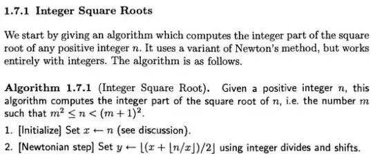

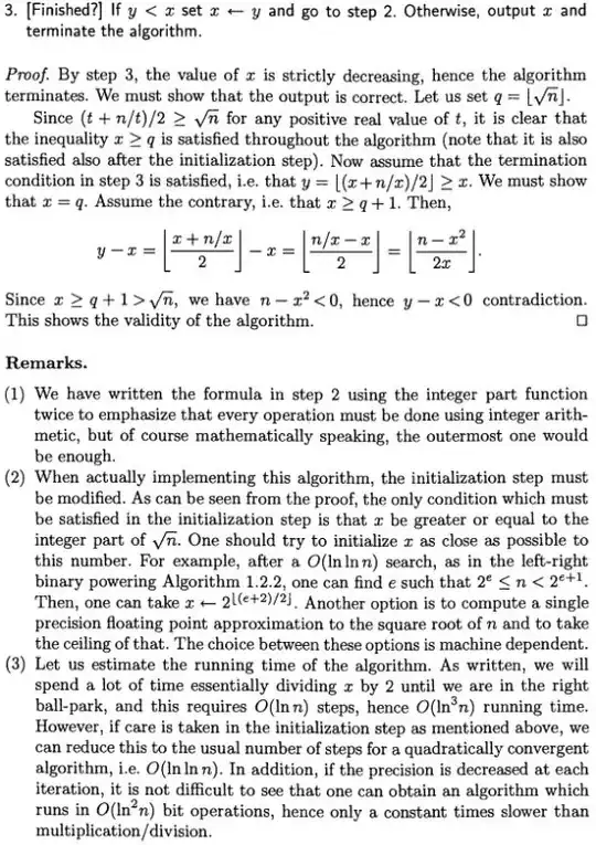

The following should suffice, from Cohen: A course in computational algebraic number theory. enter image description here enter image description here
