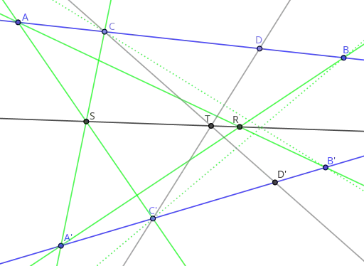

If you are looking for a straightedge-only construction of a cross-ratio-preserving map between the points of two lines, here is one. I call it Pappus-like because it uses the Pappus line.
Transferring crossratio
Given different lines $L,L'$ with pairwise distinct points $A,B,C$ on $L\setminus L'$ and pairwise distinct points $A',B',C'$ on $L'\setminus L$, first construct the Pappus line $\overline{RS}$ as shown above.
Then, given $D$ on $L$, construct $T$ as the point of intersection of $\overline{C'D}$ with $\overline{RS}$, then $D'$ as the point of intersection of $\overline{CT}$ with $L'$.
In the latter two steps you can use $(A,A')$ or $(B,B')$ in place of $(C,C')$; the result for $D'$ is the same as long as $D$ remains on $L$.
In particular, the resulting map $D\mapsto D'$ maps $A\mapsto A'$, $B\mapsto B'$ (using Pappus's theorem) and $C\mapsto C'$.
The proof that the cross-ratio of $A,B,C,D$ equals that of $A',B',C',D'$ is left as an exercise to you. Note that the transformation according to this recipe is singular because its image is constrained to $L'$. Therefore you cannot simply argue algebraically with the multiplicativity of determinants to deduce that cross-ratio is preserved. There are ways around that obstacle, but I prefer direct calculation using a homogenous coordinate system where $A,B,A',B'$ have coordinate tuples $(\pm 1:\pm 1:\pm 1)$.
