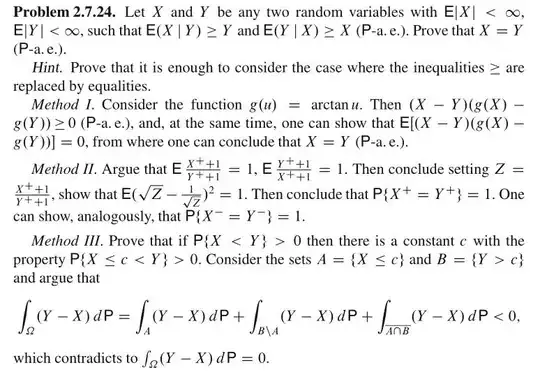

This is an interesting question and there are several text books to mention it. The following is copy from A.N. Shiryaev, Problems in Probability, Springer, New York, 2012, p207. enter image description here
