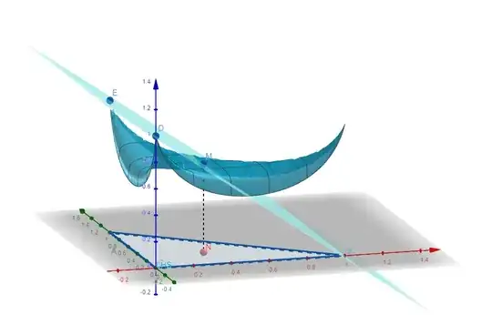

Hint: Normalize both sides by $\sum_i f(i)$ and take a look at case $n=3$:
Geometry of the case n=3
Red axis corresponds to $\frac{f_2}{\sum_i f_i}$, green axis to $\frac{f_1}{\sum_i f_i}$, point $N = (\frac{1}{n},...,\frac{1}{n})$ corresponds to $f_1=f_2=...=f_n$, all points to the left of $N$ - to the convex sequences $\{f_i\}$, the curved surface corresponds to the normalized left hand side, hyperplane - to the normalized right hand side.
Rigorous proof will involve a study of the geometry of the surface given by the image of the set $\{w \in \mathbb{R}^n : \sum_i w_i = 1\}$ (simplex) under the map $w \to \prod_i w_i^{w_i} + \prod_i w_i^\frac{1}{n}$.
Detailed argument: (to be finished)
  1. Slight change of notation:
\begin{equation} f_i := f(i) \quad w_i := \frac{f_i}{\sum_i f_i}. \end{equation}
Our inequality becomes
\begin{equation} \prod_i f_i ^{w_i} + \prod_i f_i^\frac{1}{n} \leq f_1 + f_n. \end{equation}
  1. Divide both sides of inequality by $\sum_i f_i$:
\begin{equation} \prod_i w_i^{w_i} + \prod_i w_i^\frac{1}{n} \leq w_1 + w_n. \end{equation}
One can recognize entropy probability ($\exp(-H(w))$ where $H(w)$ is the entropy of distribution $w$) and geometric mean in the functions on the left side.
\begin{equation} E(w) := \prod_i w_i^{w_i} \quad G(w) := \prod_i w_i^\frac{1}{n}. \end{equation}
  1. Left hand side has a critical point $\bar w = (\frac{1}{n},...,\frac{1}{n})$.
  2. Study of Hessian evaluated at this $\bar w$.
  3. Study the behavior of $L(\lambda; w^*) = E(\lambda \bar w + (1-\lambda) w^*)+G(\lambda \bar w + (1-\lambda) w^*)$ depending on $w^*$.
  4. ...some more math gymnastics...
