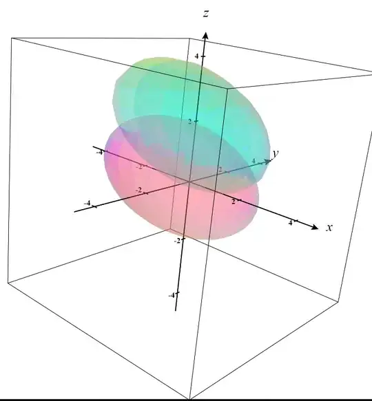

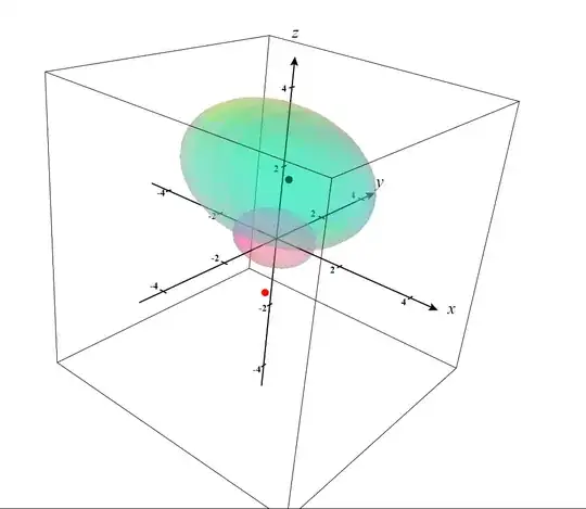

How does one translate the ellipsoid given above to the origin and have the equation of the form?: $ax^2 + by^2 + cz^2 + 2fyz + 2gxz + 2hxy = 1$

  • Note, by the way, that to get a $1$ on the right-hand side, you’re likely going to have to rescale the equation after translation. In particular, the remaining coefficients will not be the same ones that you started with. In the illustration that you added, it looks like you’ve simply deleted the linear terms and set the constant term to $-1$ without making the appropriate adjustments to the remaining coefficients, which is why the two ellipses in your diagram are different sizes. – amd Oct 24 '19 at 06:45
