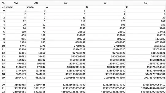

Pythagorean triples where $A-B=\pm1$ are some of the rarest; the $19^{th}$ has terms $A,B,C$ in the quadrillions. I found a formula in a book, "Pythagorean Triangles" that generates them in sequence beginning with a seed triple $T_1=(3,4,5)$: $A=3A+2C+1\quad B=3A+2C+2\quad C=4A+3C+2$ will generate $T_2=(20,21,29)\quad T_3=(119,120,169)\quad T_4=(697,696,985)$ and so on. Nineteen iterations gives you the first $19$ triples and that is great but I developed a formula which uses less computation until you get to the $n^{th}$ triple you want to view. It generates the parameters $(m,n)$ to feed Euclid's formula:$$A=m^2-n^2\quad B=2mn\quad C=m^2+n^2$$
The formula is $\quad m_{x+1}=2m_x+n_x\quad n_{x+1}=m_x\quad $ and generates the following pairs with a seed: $P_0=(1,0)$. $$P_1=(2,1)\quad P_2=(5,2)\quad P_3=(12,5)\quad P_4=(29,12)\quad P_5=(70,29)\quad P_6=(169,70)\quad ...$$
I would like to be able to generate the $6^{th}$ or the $1000^{th}$ pair directly without generating $1$-thru-$5$ or $1$-thru-$999$ to get there but I haven't been able to figure out any way to generate an individual pair directly. I have tried $2=2^1, 5=2^2+2^1, 12=2^3+2^2, hmm, 29=2^4+2^3+2^2+2^1+2^0 $ and other things like factors of $2,5,12,29...$ and I'm out of ideas.
Is it possible to generate an $x^{th}$ member pair using just $x$ as an input number or, by the nature of this sequence, is it required to generate all of them in order until I get to the desired pair?
Someone said my formula does not work but here it is working in a spreadsheet.

    Here you may find an algorithm for the efficient computation of Fibonacci/Lucas numbers by repeat squaring: https://math.stackexchange.com/a/2081266/44121. In your case you have to generate Pell numbers, but the principle is pretty much the same: in order to compute $(P_{2m},P_{2m+1})$ you only need $(P_m,P_{m+1})$. – Jack D'Aurizio Oct 18 '19 at 17:41
  • @ Jack D'Aurizio The equation from the Pells equation page: $$P_n=\frac{(1+\sqrt{2})^n-(1-\sqrt{2})^n}{2\sqrt{2}}$$ is perfect for my needs. – poetasis Oct 18 '19 at 18:46

  • The equation in my comment to your comment above is all I need. I put it in a spreadsheet and the numbers out are perfect. Your answer showed a variation of it so I marked yours as correct. I don't follow the rest but the rest doesn't seem to matter. Now I can embed this equation somewhere and generate the $1000{th}$ parameter pair or Pythagorean triple in one step. Thank you. – poetasis Oct 18 '19 at 18:55
