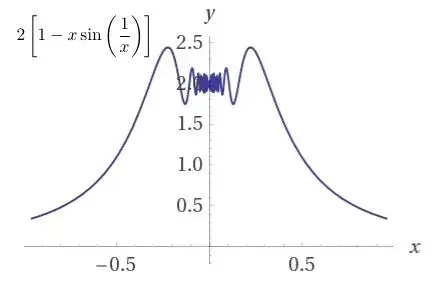

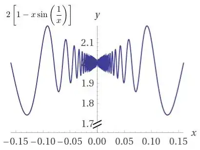

I was idly exploring properties of this strange function exploiting wolframalpha and I can't understand it. Some calculus seems to show that this function is defined only for $x>\frac{1}{2}$ (if $x \le \frac{1}{2}$ the integral diverges) and has a minimum near $1$ (maybe in $1$?). Maybe for bigger $x$ the function has limit $1$. For $x > 1$, $f(x)$ seems takes the form $\xi(x) \Gamma \left( 1 - \frac{1}{x} \right)$ (but $\Gamma$ function is surely present even in points smaller than 1, for example $f \left( \frac{3}{5} \right) = \frac{9\sqrt{3}}{32} \Gamma \left( \frac{1}{3} \right) \approx 1,3 $) where $\xi(x)$ satisfies
$\xi \left( \frac{4}{3} \right) = \frac{2}{7} \sqrt{2 - \sqrt{2}} $
$\xi \left( \frac{3}{2} \right) =\frac{3}{10}$
$\xi \left( 2 \right) = \frac{\sqrt{2}}{3} $
$\xi \left( 3 \right) = \frac{3\sqrt{3}}{8} $
$\xi \left( 4 \right) = \frac{2}{5} \sqrt{2 + \sqrt{2}} $
$\xi \left( 5 \right) = \frac{5}{12} \sqrt{\frac{5+\sqrt{5}}{2}} $
$\xi \left( 6 \right) = \frac{3}{7} \sqrt{2+\sqrt{3}} $
... I can't see a pattern and I have no idea of how wolframalpha was able to solve these integrals (but it can't solve the general integral, it solves only if I assign a value to $x$). In addiction $f(1)$ has the simple value $\frac{\pi}{4}$, this suggests an charming way of seeing $\pi$: it is the area under this pathological function enter image description here enter image description here
