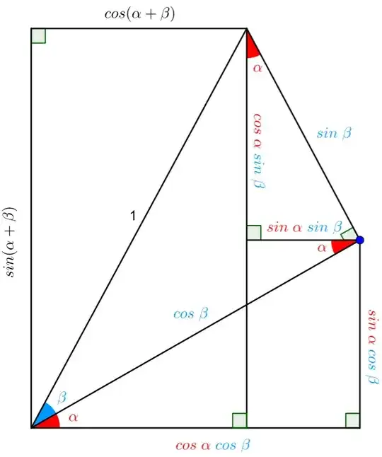

What is the proof that the α angles are equal? I can see that the lower and middle angles are equal because they are "alternate interior angles". I can deduce that the middle and upper angles are equal too, but how do you express it formally?
https://i.stack.imgur.com/81sHd.png

The angle $\alpha$ in the middle on the right is equal to the bottom left angle $\alpha$ since alternate angles are equal. There is a right angle at the blue dot, so the angle next to $\alpha$ here must be $\pi/2-\alpha$. Then use the right-angled triangle in the top right.
