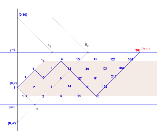

We start with an example confirming the approach of @GCab.
Example (part 1): k=2, m=14, n=6
We count the number of valid paths from $(0,2)$ to $(14,6)$, which is the number of lattice paths from $(0,2)$ to $(13,5)$ which do not touch the lines $y=0$ and $y=6$, followed by an $m$-th step from $(13,5)$ to $(14,6)$.
We see in accordance with the table presented by @GCab that we have $\color{red}{364}$ valid paths which is marked red in the graphic below.
![enter image description here
We can normalise the situation by shifting $(0,k)$ to $(0,0)$ and consider the equivalent problem to count the number of lattice paths from $(0,0)$ to $(m-1,n-1-k)$ using steps $(1,1)$ and $(1,-1)$ without reaching the boundaries $y=n-k$ and $y=-k$. We denote this number of valid paths by \begin{align*} L_{m-1,n-1-k;n-k,k} \end{align*}
Formula:
The formula above in the form $L_{m,n;r,s}$ counting valid paths from $(0,0)$ to $(m,n)$ which do not reach the boundaries $y=r$ and $y=-s$ is established in this post. It can be written as
\begin{align*} L_{m,n;r,s}&=\binom{m}{\frac{m+n}{2}}-\sum_{j\geq1}\left[\binom{m}{\frac{m+n}{2}-r+j(r+s)} +\binom{m}{\frac{m+n}{2}+s-j(r+s)}\right]\\ &\qquad\qquad\qquad+\sum_{j\geq1}\left[\binom{m}{\frac{m+n}{2}+j(r+s)} +\binom{m}{\frac{m+n}{2}-j(r+s)}\right]\tag{1}\\ \end{align*}
In the current situation we obtain from (1) the number of valid paths for OP's problem:
\begin{align*} &\color{blue}{L_{m-1,n-1-k;n-k,k}}=\binom{m-1}{\frac{m+n-k}{2}-1}\\ &\quad\qquad-\sum_{j\geq1}\left[\binom{m-1}{\frac{m+n-k}{2}-1-n+k+jn}+\binom{m-1}{\frac{m+n-k}{2}-1+k-jn}\right]\\ &\quad\qquad+\sum_{j\geq1}\left[\binom{m-1}{\frac{m+n-k}{2}-1+jn}+\binom{m-1}{\frac{m+n-k}{2}-1-jn}\right]\tag{2}\\ &\quad=-\sum_{j\geq0}\binom{m-1}{\frac{m+n-k}{2}-1+k+jn}-\sum_{j\geq1}\binom{m-1}{\frac{m+n-k}{2}-1+k-jn}\\ &\quad\qquad+\sum_{j\geq0}\binom{m-1}{\frac{m+n-k}{2}-1+jn}+\sum_{j\geq1}\binom{m-1}{\frac{m+n-k}{2}-1-jn}\tag{3}\\ &\quad\,\,\color{blue}{=\sum_{j=-\infty}^{\infty}\left[\binom{m-1}{\frac{m+n-k}{2}-1+jn}-\binom{m-1}{\frac{m+n+k}{2}-1+jn}\right]}\tag{4} \end{align*}
Comment:
  • In (3) we shift in the left-most series the index by one to start with $j=0$. In the third series we merge the single left-most term from (2).
  • In (4) we combine the two-right most series as well as the two left-most series.
The resulting probability is \begin{align*} \color{blue}{\frac{1}{2^m}L_{m-1,n-1-k;n-k,k}} \end{align*}
The sums in (2) are a consequence of applying the principle of inclusion-exclusion to reflected paths. This is necessary in order to compensate double counting as indicated in the answer from @Hans.
Example (part 2): k=2, m=14, n=6
In order to check (2) we calculate the number of valid paths from the example above.
We obtain
\begin{align*} \color{blue}{L_{13,3;4,2}}&=\binom{13}{8}-\left[\binom{13}{10}+\binom{13}{4}\right]+\left[\binom{13}{2}\right]\tag{3}\\ &=1\,287-(286+715)+78\\ &\,\,\color{blue}{=364} \end{align*}
in accordance with the first part of the example. Note the number of reflected paths in the brackets in (3) are indicated in the graphic by $A_1, B_1$ and $B_2$.

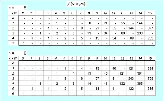

The standard approach would be through Markov matrix.
The transition matrix , denoting the probability of changes in the capital at each run, is simple. For $n=4$ for example, it is $$ {\bf T}(4) = \left( {\matrix{ 1 & 0 & 0 & 0 & 0 \cr {1/2} & 0 & {1/2} & 0 & 0 \cr 0 & {1/2} & 0 & {1/2} & 0 \cr 0 & 0 & {1/2} & 0 & {1/2} \cr 0 & 0 & 0 & 0 & 1 \cr } } \right) $$ and computationally it works pretty well. Taking the various powers of the matrix (${\bf T}^m$) the $k$-th row will give the probability to get the capital corresponding to the column index.
Since at $0$ and $n$ we have an absorbing barrier, those columns will give the cumulative probability of losing or winning.
In this way we get for example, for $n=5,6$, the following tables for $f(n,k,m)$
Gambler_ruin_1
which correspond with yours. However the results are difficult to render in analitical terms, because the Jordan canonical form is complicated and possible splittings into simpler components leads to non commutative terms.
