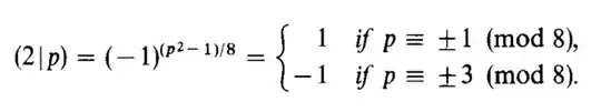

By Euler's Theorem, we know that $(2|p)\equiv 2^{\frac{p-1}2}\pmod{p}$. Since, in your case $(2|p)=1\implies$ a prime number will be in your list if and only of $2^{\frac{p-1}2}=1$ in $\mathbb{Z}_p$ enter image description here
Thus, we get enter image description here
Reference: Tom Apostol's Introduction to Analytical Number Theory

    This is, of course, correct. It looks like an image from a text. That's quite acceptable, but If so, please provide the reference. – Ethan Bolker Sep 12 '19 at 14:09
